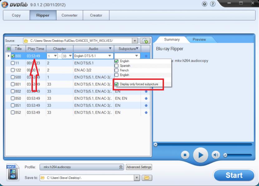

So, I finally decided to download and try out V9 --- All installed okay and registration was not a problem either --- So far so good. Copied a 20 minute chapter from my 'Gladiator' BD okay and then ripped this to an MKV -- Again, so far so good except for the following; Any assistance on these points would be appreciated;
1) Where is (or is there any?) the selection for "Display Forced Subpicture only"? --- Can't find the darned thing anywhere - I used to be able to select 'Direct Render to Video" (still can in V9) and then 'Forced...etc'
2) Lightning Recoding --- On or Off? Can't really see this makes any speed difference at all on my setup --- Is it worth having this on?
3) Where can I change the file name when copying or ripping? It was there the first time I ripped the 'Gladiator' copied file to MKV but when I went back in to try it again with slightly different settings, I could'nt find it anywhere?
V9 Does'nt seem to be any faster than V8222 and the interface is not that difficult to navigate by --- It still uses the same amount of CPU/GPU resources as the old versions ---- So what's the major changes from V8? Replies in easy to understand terms please --- Thanks
