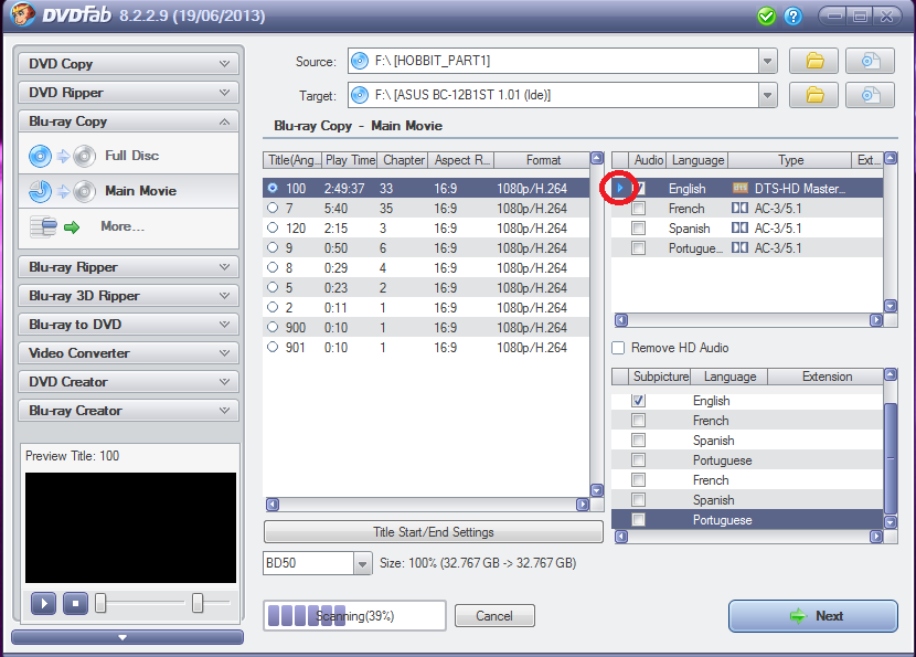

                      Check the attached picture, the arrowhead I've circled sets the default audio stream that plays when the movie starts. Check the box in the stream you want and move the arrowhead to it. And cool your jets if you expect to hang around here.

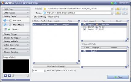

                        I tried every combination and still either get commentary or silence. Over a year a go maybe longer is when this problem began. It use to be all I had to do is check off the "No HD Audio" but not any more. As a matter of fact every once in a while I get the commentary for the blind.
                        When I tried just the hd one I get silence with and without checking off the hd audio box.
                        the next two no matter what I do gives me commentary.
                        As for the arrow It moves on its own. I've moved it and tried it in every combo I can do.
                          You have all the audio tracks checked so you get them all. You can't change them with the player's remote? If not try just ticking the audio track you want and uncheck the rest. Meantime I'll try one and see what I get.
                            I just ripped a BD and checked everything, both audio and subtitles and they are all selectable via the player remote. I did main movie 50GB, I think that's what your screen shot showed, a little hard to read.

                              I have done all that. The pic I put up is just to show how many audio choices I have to choose from. It shouldn't be that hard to trouble shoot.
