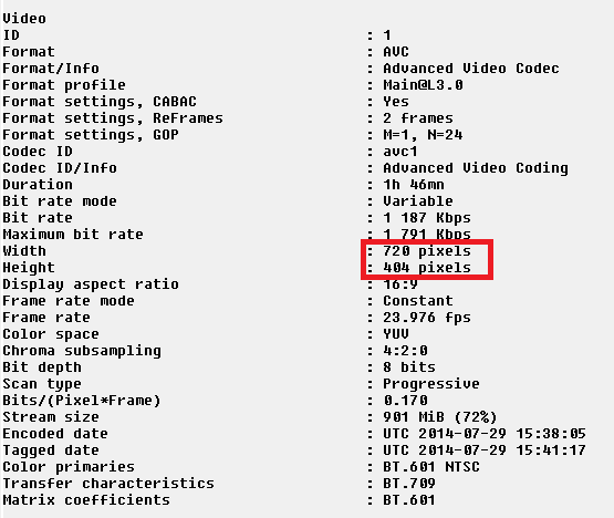

        It might be useful to download a free program- MediaInfo and compare the actual resolution to the Fab settings. I can't reproduce your issue but don't doubt you. I'll attach a screenshot of the MediaInfo results for the MP4 I just completed, the result matches the setting:

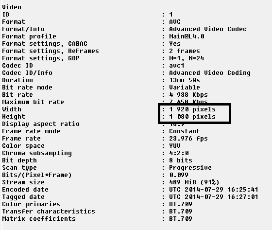

          This is from a BD. I always turn off automatic cropping content to watch them as intended:
