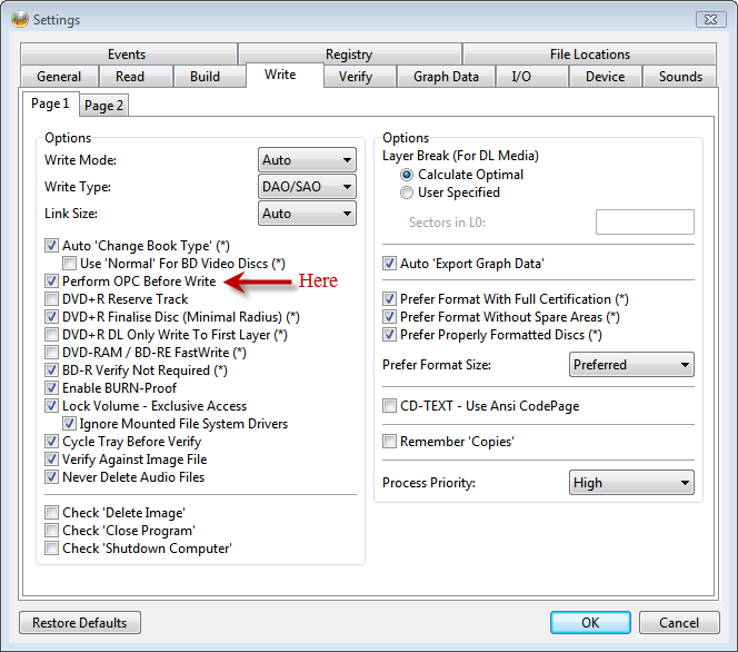

          Medium error, Power calibration fail (CD-burner is dirty) Please try cleaning your drive or Install ImgBurn using the link in my signature and checking the box in ImgBurn settings see pic

              I believe it is the blank discs you are using, cleaning the drive was just the error you received along with the power calibration error. If having trouble setting up ImgBurn you can copy the movie to your Hdd then use ImgBurn out side of Fab to burn the disc make sure you check the OPC box in ImgBurn shown in my pic before burning.

                  Ritec that also makes Memorex dvds are always troublesome their very cheaply made and have a long history or causing burn problems with this said if you are still going to use them use the slowest burn speed these disks can burn at and you may get by but do use img. burn burner with OPC before burn checked in img burn settings this will adjust the laser to the disk you are using causing less error's if you use the slower burning speed.
