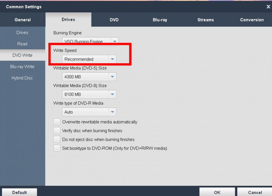

    How do I increase the write speed to disk. The common settings only allows a speed of 4. Consequently, it takes in excess of more the 60 minutes to complete a copy. I am in region 1 using version 9316. Thanks
    If your using cheap media like Memorex also know or made by Ritek you may need to slow the burn speed down it's best to use 1/2 rated disk speed if 8x burn at 4x as a general guide I leave it set in Fab settings to recommended burn speed it's a pull down box.

          In the screen shot I posted before the( burn engine drop down box) is above the settings for speed.Their you can select burner VSO burner best for dvd's,fab burner for blu rays and 3d blu rays.img burn for both.

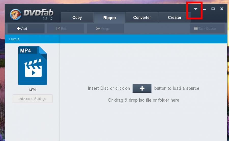

          The new screen shot shows a arrow click on it, a drop down box appears then select log files and burn log open it and cut and past that log file to a post.

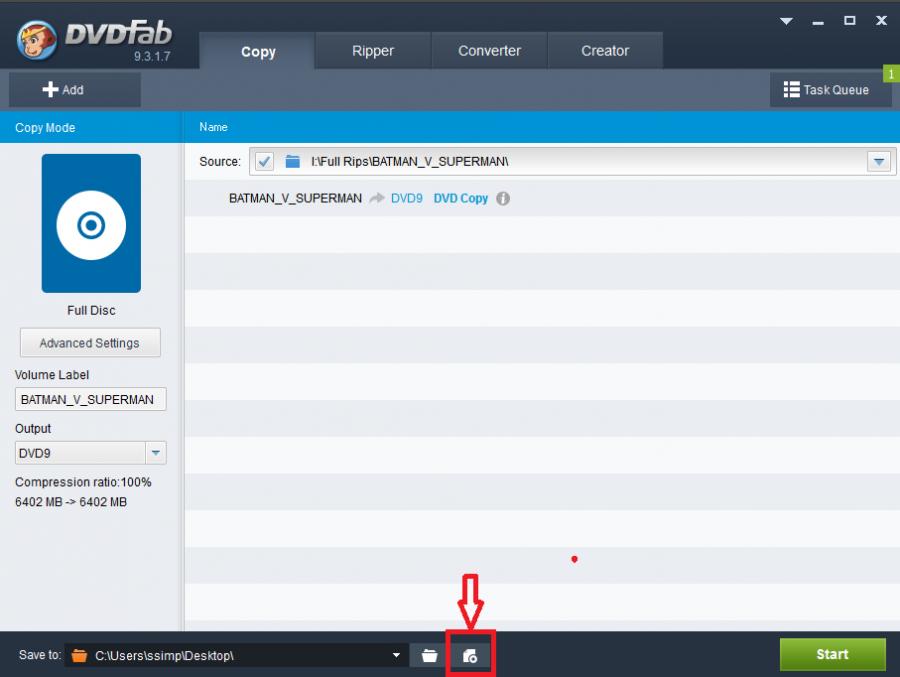

                      jetman4615 to make an iso just click the icon I have shown below and you'll need to select a folder to write the iso to since they are always written to the hard drive. Easy peasy.
                            That could not be any simpler. Thanks
