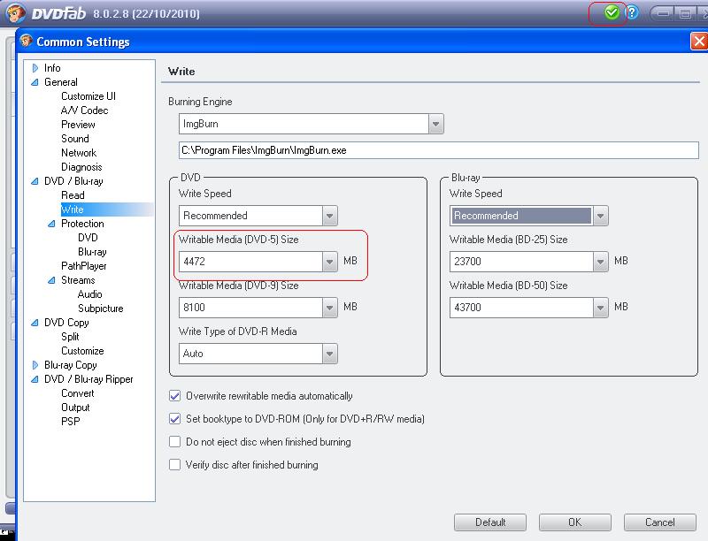

                A couple of things to check: be sure the quality box (center bottom) is set to DVD-5 for a single layer blank. And check the green circle to go into common settings then go down to “Write” and make sure the DVD-5 setting does not exceed 4472, that will make do what you describe. See attachment:
                The advice from CBR929 is probably the best you are going to get!
