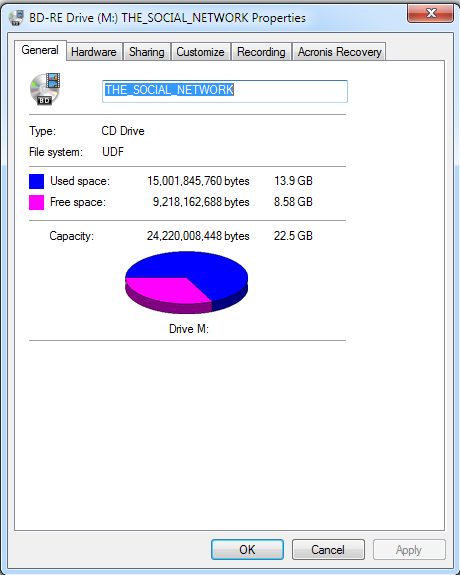

      The movie with DTS audio movie only is 13.9 GB here is a screen shot and the movie plays just fine, no glitches! This is not a protected back up. Not sure whats going on with Fab it could be reporting wrong I dont know but 13.9 is right!
