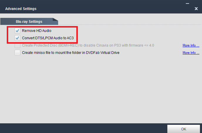

    When making a movie only copy in BD25 BluRay format from a BD50, I select the options to "Remove HD Audio" and to "Convert DTS/LPCM Audio to AC3" in "Advanced Settings."
    The resulting copy still has DTS audio instead of the AC3 I was expecting. I was converting audio to make more room for the converted video.

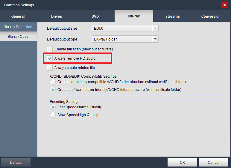

                      If I set it in both places it will convert the audio but if I forget one or the other it won't. Once in common settings and once in advanced settings after I select the source:

                        I tried setting the option in common settings, along with the others, and it didn't make it convert for me. I'm fairly confident that DVDFab is analyzing the first piece, seeing AC3, and then deciding that there is no conversion to be done.
