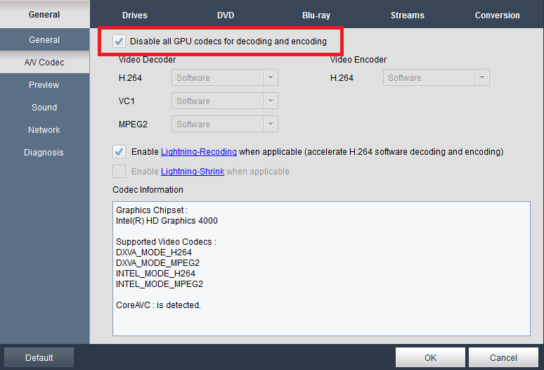

                You might also turn off CUDA, your card is really marginal. Stranger things have happened See attached:
                  That did the trick. I had thought late last night about trying another test today with gpu accerlation disabled today. Your post reminded me of it and it worked for Elysium. Still had a problem with JOBS as fab 9 still did not see it and i tried many things.
                  Finally i had downloaded a trial version of another player and started it since my other pc player did not see it. After short while of disc spinning suddenly it was recognized and then Fab 9 saw it all of a sudden and then was able to get it backed up also. Thanks a bunch for all assistance from everyone involved
                    Glad you got it sorted Curt!
