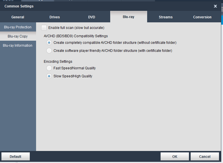

I recently made a back up using DVD Fab Blu-Ray Copy of the Region B "Lost Highway" BD and the back up will play on my PS4, but when I put it into my PS3 the Universal title screen plays, and then it just freezes while trying to load the top menu. Is there something I'm doing wrong? I'm using Verbatim Dual Layer BD-Rs and the attached images are my settings. Thank you for your help!
Copy will play on PS4, NOT PS3

I tried the disc on BOTH my PS3s (yeah, I have 2) and it did the same thing on both. Just perplexing why it will work on the Ps4... I feel like I'm so close to having this down, I must just be doing one little thing wrong!
