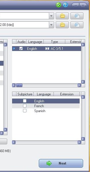

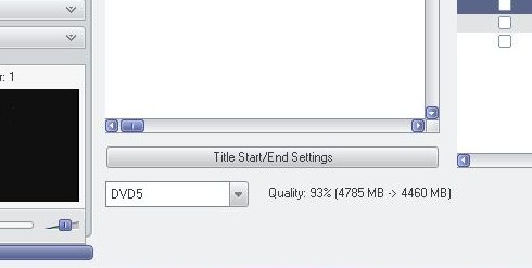

      cameltoe, Are we talking about the main movie file size to fit on your blank disc?
      If so insert your Blu-Ray movie disc in your drive open up DVD Fab let it analyze the disc with the main movie option in Fab, pick your audio and sub picture options on the right see pic, then on the bottom see pic it will show you the quality with compression to fit on your blank media. Mine shows DVD as I do not have Blu-Rays.

          #19
          cameltoe you will set it as BD25 if you are doing main movie as Fab can only do main movie compression at this time and that is the size of the disc's that you mentioned in previous post.
                                is "sub picture options" subtitle or different?
