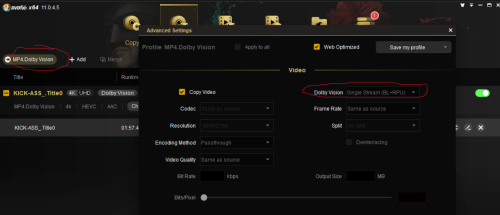

    Set it to "Single Stream", you will get what you need. Click image for larger version  Name:	setting.png Views:	1 Size:	138.0 KB ID:	371690
    You can use the tool Mediainfo to analyze the output file to check out its media info.
