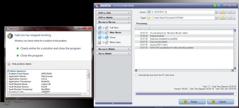

    Okay so this has been annoying me for the past few days now. I've only been able to successfully rip about 2 Blu-Ray movies out of 6.
    Here's the problem:
    After the "Analyze" phase it just crashes! Here's the error report...
    Problem signature:
    Problem Event Name: APPCRASH
    Application Name: FabCore.exe
    Application Version: 1.0.5.1
    Application Timestamp: 4bc6e32c
    Fault Module Name: codecs.dll
    Fault Module Version: 0.0.0.0
    Fault Module Timestamp: 4bc0362e
    Exception Code: c0000005
    Exception Offset: 000905ce
    OS Version: 6.1.7600.2.0.0.768.3
    Locale ID: 1033
    Additional Information 1: 0a9e
    Additional Information 2: 0a9e372d3b4ad19135b953a78882e789
    Additional Information 3: 0a9e
    Additional Information 4: 0a9e372d3b4ad19135b953a78882e789
    I've attached a screenshot of the error. It seems to always crash after the
    "DXVA GPU acceleration..." step. I've already unchecked the box to disable the DXVA Acceleration in the "Preview" option. It still crashes.
    If anyone could help me out I'd greatly appreciate it. I've tried looking up how to disable DXVA in other ways besides through DVDfab. Nothing I've tried has worked. It's very irritating aghhhh. THANKS

                      Hey CBR. Okay so I reinstalled DVDfab by right lcicking the installation file and selecting "Run as Administrator." I just tried to rip my District 9 disc and I'm still getting the same damn error! I think it has something to do with this DXVA crap. Even when I UNCHECK it in the DVDfab settings it still says that it's enabled in the live log as it's ripping. I don't know what to do AHHH
                        SaMirakle,
                        you can't simply "uncheck" DXVA GPU acceleration. Yes, you can disable DXVA Acceleration for preview, but it has nothing to do with you issue, especially when preview (according to your screenshot) not even activated.
                        However, in order to disable DXVA Acceleration for encoding/decoding, you have to go to Settings ->General ->A/V Codec and set all drop-downs to "software". Restart DVDFab. Now you have GPU Acceleration disabled.
                        Another thing, before you do all this, I would recommend to download and install latest version 7.0.5.1
                        In general, I have to tell you that root of your problem is in your Videocard, not in DVDFab. First you should start with, is to check for driver update. From your error, you can see that there's filter incompatibility. Since DVDFab updates quite frequently and using latest filters, it's possible that driver for your card is far behind. If you, in fact, find that you videocard driver outdated and you update it, please enable GPU Acceleration and try again.
