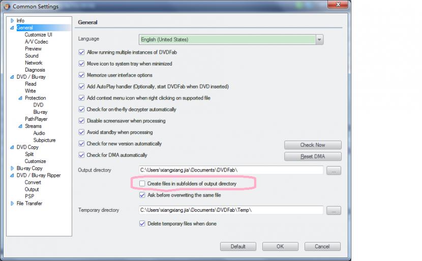

    I was wondering why I cannot seem to get the movies to save exactly where I want. Before I started using DVDfab I just set things up so the ISO file would save on my server, Z:\Movies\.
    So that's what is showing under the output directory in DVDfab now, and I unchecked create files in subfolders.
    But everytime I click on the ISO icon it creates a ISO folder under Z:Movies putting it Z:\Movies\ISO\. So none of my movies are saved where I want, and I don't like having to open a ISO folder.
    So, am I missing something or is that just the way DVDfab works? Of course if I set it manually, it goes to the right place. But why do I have to do that?

          2. Please click the tick green icon button at the right top corner of the DVDFab screen, open "Common Settings" window, click on "General", and then untick "create a file in subfolder..." to see the result.

            OK, I downloaded that and it does the same thing. So I guess my question is, is this program suppose to create a ISO folder when creating a ISO file when using the icon button? I mean I'm telling it where to go in the output directory under general, but its not doing what I want. It does the exact same thing whether the subdirectory is checked or not.

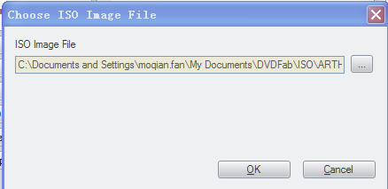

                  Please click the "disc with paper" icon when selecting the target to change the output directory of ISO file. "Memorize user interface options" at "General", common settings window, does not apply to this feature. You have to change it manually.
                  Note: If you do not do any change, the default output directory is: C:\Users\User Nmae\(My) Documents\DVDFab\ISO\xxx.iso, as you can see, there will be an ISO folder;
                  If you change it to anywhere else, it will not creat an ISO folder.

                    Please choose your iso storage path manually. Please see the attchment.

                      But then when I load the movie and click what I call the ISO icon, the one beside folder, the output path isn't exactly what I put in the output directory under general. It adds ISO and creates a ISO folder.
                      Now, as I said before, I can manually change it after it pops up asking if that is where I want it, and yes then it saves in the right place. I think that is where the cici Jia put a attachment telling me to change it.
                      Yes, I can do that but its not remembering because the next time it does the same thing. It creates a ISO folder even though I have the output directory changed under the general tab. So, is that not what its for? I mean sure I can change it when I get ready to copy the disc,but it just takes more time and seem strange it won't just save it.
