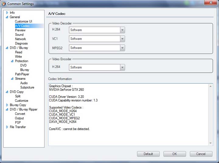

              Also recommend that you change the A/V Codec settings in Common Settings to all software as shown:
Name:	AV Codec 2.jpg
