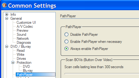

    The simplest and easiest initial steps are:
    1). Clean the disc regardless of how pristine it appears
    2). Disable PathPlayer (Common Settings in Fab)...or enable it, depending on your current settings.

      Thanks for the answer. I cleaned the disk but I can't figure out where to find the Common window. I put the clean disk in but it is still having to ignore errors so maybe its a bad disk. But I could use help finding the Common Settings.
        see attachment for common settings.
          Hey G
          Your first attachment should say click on check mark.

                    0m 52.80s: blu-ray2blu-ray have 4 elements.
                    0m 52.89s: blu-ray2mobile have 17 elements.
                    0m 53.84s: blu-ray23d have 7 elements.
                    0m 54.27s: blu-ray2dvd have 1 elements.
                    0m 54.33s: file2mobile have 27 elements.
                    0m 55.97s: file2dvd have 1 elements.
                    0m 56.03s: file2bluray have 1 elements.
                    0m 56.76s: Config work ui controls successful.
                    0m 28.72s: Init burn engine successful.
                    0m 29.01s: StartNotify successful.
                    0m 41.80s: detected dvd
                    0m 41.85s: drive E
                    0m 41.85s: dvd type 1
                    0m 41.86s: volume label SCOOBY_DOO_MYSTERY_BEGINS
                    0m 42.02s: detected dvd
                    0m 42.03s: drive F
                    0m 42.03s: dvd type 1
                    0m 42.03s: volume label
                    0m 44.37s: detected dvd
                    0m 44.63s: drive E
                    0m 44.63s: dvd type 1
                    0m 44.63s: volume label SCOOBY_DOO_MYSTERY_BEGINS
                    0m 45.33s: got copyright 1 f0
                    0m 54.67s: got udf/iso
                    0m 02.75s: got discinfo
                    0m 02.77s: pathplayer enabled
                    0m 50.47s: read error: 0 -684629093 1979747867 345814 6227215 166129808 345814
                    0m 17.65s: pathplayer drive error 1
                    0m 17.66s: pathplayer drive error 1
                    0m 17.68s: failed to open disc 1
                    0m 17.88s: css adjustment
                    0m 17.88s: failed to send challenge: sensekey 05 asc 21 acsq 00
                    0m 18.15s: css adjustment
                    0m 18.16s: failed to send challenge: sensekey 05 asc 21 acsq 00
                    0m 18.43s: css adjustment
                    0m 18.44s: failed to send challenge: sensekey 05 asc 21 acsq 00
                    0m 18.64s: got copyright 0 0
                    0m 18.80s: got udf/iso
                    0m 18.80s: failed to open disc 203
                    DVDFab 8.1.5.9 (2012/01/30 16:33:38)
                    0m 07.31s: Qt Translator file load success
                    0m 07.52s: Load config successful.
                    0m 07.93s: Init profile data driver sucessful.
                    0m 19.55s: Init GPU settings sucessful.
                    0m 19.56s: option dvd2dvd 1 dvd2mobile 1 bluray2bluray 1 bd2mobile 1 bd23d 1 bd2dvd 1 file2dvd 1 file2bluray 1 file2mobile 1 filemover 1
                    0m 19.65s: dvd2dvd:dvd2mobile:blu-ray2blu-ray:blu-ray2mobile:blu-ray23d:blu-ray2dvd:file2mobile:file2dvd:file2bluray:
                    0m 20.15s: Config ExBar successful.
                    0m 20.15s: dvd2dvd have 8 elements.
                    0m 20.59s: dvd2mobile have 28 elements.
                    0m 22.40s: blu-ray2blu-ray have 4 elements.
                    0m 22.50s: blu-ray2mobile have 17 elements.
                    0m 23.53s: blu-ray23d have 7 elements.
                    0m 23.96s: blu-ray2dvd have 1 elements.
                    0m 24.03s: file2mobile have 27 elements.
                    0m 25.75s: file2dvd have 1 elements.
                    0m 25.80s: file2bluray have 1 elements.
                    0m 26.53s: Config work ui controls successful.
                    0m 26.85s: Init burn engine successful.
                    0m 27.09s: StartNotify successful.
                    0m 28.80s: detected dvd
                    0m 29.08s: drive E
                    0m 29.08s: dvd type 1
                    0m 29.09s: volume label SCOOBY_DOO_MYSTERY_BEGINS
                    0m 29.36s: detected dvd
                    0m 29.37s: drive F
                    0m 29.37s: dvd type 1
                    0m 29.38s: volume label
                    0m 29.64s: got copyright 1 f0
                    0m 38.19s: got udf/iso
                    0m 44.68s: got discinfo
                    0m 44.69s: pathplayer disabled 0
                    0m 50.11s: got dvdinfo
                    0m 50.27s: opened dvd
                    0m 14.00s: read error: 3 30954 2051651 248205 0 2 30954
                      Hi joyceww
                      To tell if you have a bad disc please download VSO Inspector found here http://www.vso-software.fr/products/.../inspector.php and install it.
                      Put the disc in your drive and as the movie starts playing pause it, but do not exit out, now launch VSO Inspector, click scan and let it scan the disc.
                      If you have errors then you have a bad disc.
                      CBR929
