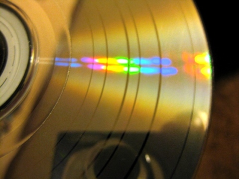

                        One last thing ward1941uk, if you go shopping on the net for a mod chip you might run across advertisements for software that can copy your game disk and run without a mod, these are scams! I have attached a picture of my boot disk and you can see the unwritten portions on the disk, the PS2 checks for these during the boot. The DVD burners we have in our computers can't do this. And no software can make it do it, at least not yet and likely never will. The mod chip that is soldered in the console bypasses this part of the boot sequence. So don't waste your money on software, you already have as good as it gets.
