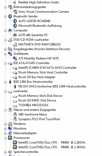

      In device manager, are you able to expand the
      Intel(R) ICH9M-E/M SATA AHCI Controller?
      I suspect you have at least 2 controllers?
      I hate to ask, but could you post a screenshot of your expanded device manager?

        3. I've attached a picture of my expanded device manager. I cannot expand the AHCI Controller, which I believe is normal for an AHCI Controller (my limited google-knowledge talking here...).

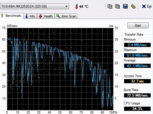

        4. I downloaded and ran HD Tune. I've attached the Benchmark results (not sure how to read this).
        Do the VSO Inspector and the HD Tune test confirm that my Laptop is the issue here?

            Considering this is a laptop hdd with a spindle speed of 5400 and an 8 MB cache, nothing in the benchmark test results explain the poor performance you've seen previously and ? intermittently........or is the "slowness" consistent?
