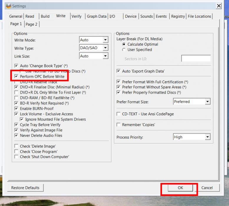

    Reading into some of your older logs you seem to be using cheap blank disks are these Ritec (Memorex) as these are junk if so get better blank media as your drive doesn't like these disks.Some drives will burn cheap disks at slower speeds.Img burn also has a setting to use to do a test burn on a unused part of the disk to adjust laser power this will sometimes help when burning disks see screen shot.

        That's a burning issue, the laser is unable to calibrate its power level to the media. I suggest switching your burning engine to ImgBurn and making sure that the box for Optimum Power Calibration is checked (OPC) for a better crack at calibration. There is a chance the laser in the drive is going out so...
