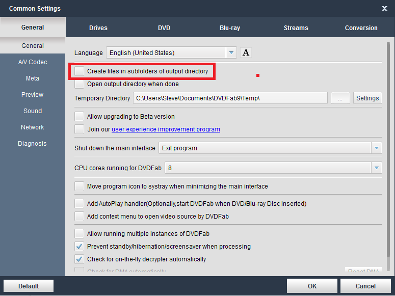

        I did what what you suggested and uninstalled the program and re-installed it and now have 9.2.2.6. I then ran a test using a DVD in clone copy to an ISO. It ran the extraction and I asked it to file the ISO in my DVDFAB folder, where all previous ISO were sent no matter whether they were clones or main movie copies. When the test was complete I went to the main folder and, as before, the ISO was not there. However, inside that main folder is another folder titled "Clone". My test ISO was there however that is not where the program said it was going to store it? I do not have a folder titled "Main Movie" therefore any main movie ISO copies I make "just disappear"?

            DVDFab v9225 or v9226
            I do not usually post anything. Both the new versions of DVDfab create a new folder in my designated save folder which is Dvdfab iso. When sellecting where to save I'm not creating a new folder the program is doing it. I know how to copy and paste to the designated folder, but never had to before. The program works great, but I don' need extra folder created.
              You might check in common settings if this box is checked, if it is a sub directory will be created wherever you save the image.
                Thank you
                I looked in my common settings and this box is checked. I will uncheck and see what happens.
                  That should take care of the extra folder.
                    Thanl\ks
                    That worked, no extra folders. The same cure might work for the other members.
                      Glad it worked for you.
