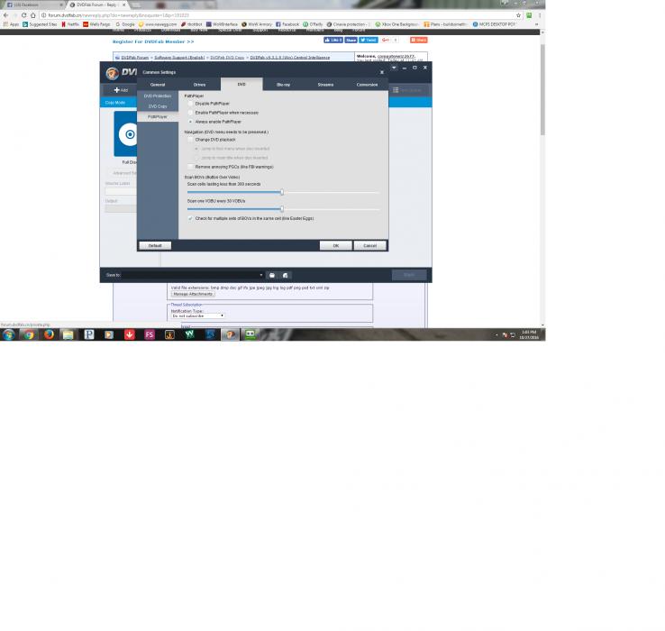

                ok it will do the copy process but not the burn.. I have the test version as mentioned above I don't think its going to cloud service
                  I noticed in your last screen shot the save to box is blank your dvd drive should be in this box if your burning to disk.

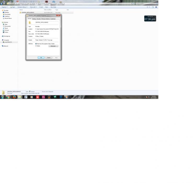

                  After fab makes the folder on hard drive what size is the folder when you put your mouse over it?

                    was this post to me or j427982 if it was for me i had already closed but reopened just to get screenshot to show i had it enabled but yes i always have a dvd or blu ray drive listed there

                      The post was for you forgot to put on your name.But we need from both of you the size of the file once the dvd is on the drive what doe's windows say when you mouse over the file size?
