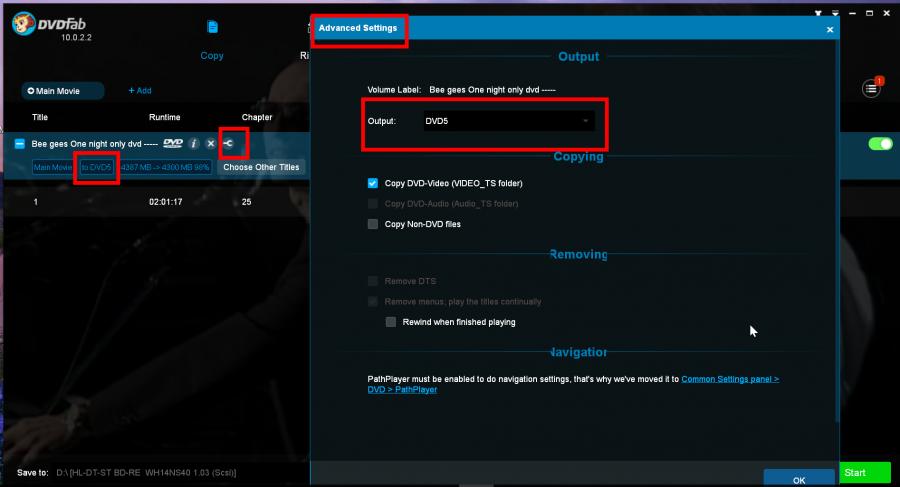

    See screen shot-place dvd in fab or in burner Click on wrench in red box (advanced settings) Make sure the pull down says dvd 5 for a single layer disk to be used is checked it then will show up on the information line also marked in red dvd5.

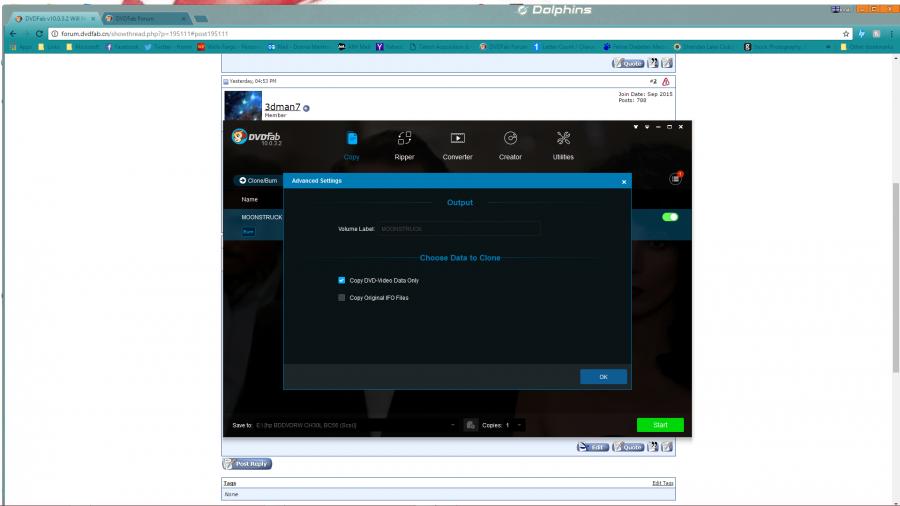

      When I click the wrench, I get a different screen than what you show....

        Looks like you are selecting "clone" which is a one to one copy and will require a dual layer blank to write. If you want everything on the original select "Full Disk" and DVD5 output to write to single layer blank.
          Thank you so much. I didn't select it...it apparently set itself like that after the update and I never noticed it. All is well now.
