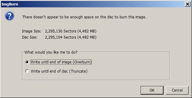

      I tried burning the .iso that was created using the 4482 MB setting.
      ImgBurn gave me this warning below as a thumbnail.
      I answered Yes to both .
      On separate burns of course.
      To a DVD +RW single layer DVD.
      The overburn had an error from ImgBurn .
      It did play the movie but at the end while the credits were running it froze.
      The truncated burn didn't show an error but did the same thing.
      To me they were unsuccessful but could be used in a pinch.
      So try a custom size like I posted or stick with the default 4300MB.

          ImgBurn read the .iso I created with DVDFab DVD Copy from one of the default as oversized. That was the 4482MB for DVD +R in the dropdown menu.
          The 4464 custom setting worked correctly.
