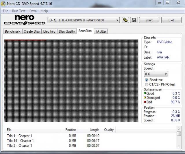

                    Sorry, but you're not using cd-dvd speed correctly.
                    It's great for benchtesting all types of media and great for scanning burned media, but
                    it will not scan encrypted discs accurately...by itself
                    Ideally, you should be running an on-the-fly decrypter...such as DVDFab Passkey when scanning.
                    Alternatively (and not as reliable), you can open the disc with a software player like VLC or Media Player Classic.
                    Then stop play, but do not exit the player.
                    Now open cd-dvd speed and scan.
                    Here's a scan of a standard, commercially pressed dvd..."Avatar"
                    I only scanned for a couple of minutes...because it gets old, but you get the idea.
                    It's erroneously showing all red = all bad sectors.
Name:	cd-dvd speed 1.jpg

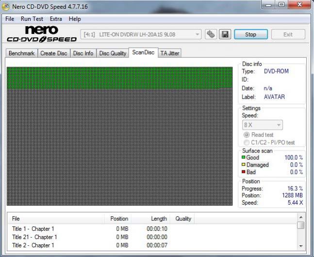

                    Here's a partial scan of the exact, same disc while running Passkey.
                    This scan took less time, made much better progress and most importantly, shows all green = no bad sectors.
Name:	cd-dvd speed 2.jpg

                      Hey AGJ, you beat me again!!!, but no fair...I've got screenshots.
                      Besides...I'm old and slow and my typing sucks
