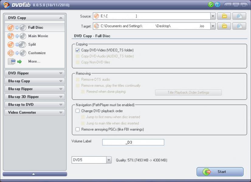

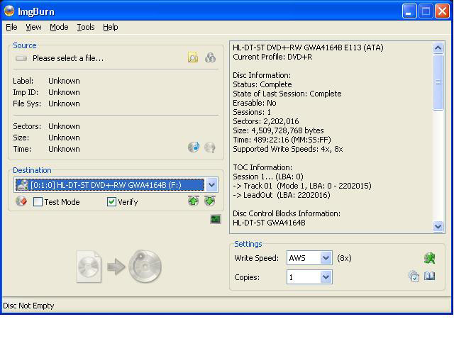

    Hello.
    I'm hoping someone can help me out here.
    I went through the steps in the sticky above about setting up Imgburn to work automatically with DVD Copy but it didn't work quite right.
    Once DVD copy was done Imgburn launched and looked like it was doing everything correctly. However, when it was finished and I tested the disc there was nothing on it. (Yes, the drive letters were set correctly.)
    After I discovered this I opened Imgburn back up and selected the .iso file manually and tried to burn again using the same disc and it seemed to work just fine.
    Does anyone have any idea what I (or Imgburn) may be doing wrong?

      Nope, the Test Mode button is not checked.

        It seems the destination for your burn isn't optical drive, but HDD. Otherwise, you can't get an ISO as being created as temp file by ImgBurn. From what you are describing (and ImgBurn isn't in test mode), destination for your burn is HDD, not your optical drive with blank media in it.

          If you are referring to the Imgburn settings, no, the destination is not HDD. It is the 2nd optical drive (F. As far as the DVD Copy settings go, yes, the destination is a local folder on the system using an .iso image and not the folder option. (Does the .iso file need to be in a specific location for Imgburn to work correctly?) My understanding is that's the correct method.

              I don't understand what you are saying. I am using DVD Fab to create the .iso and using ImgBurn to burn the DVD to happen automatically as written in the walkthrough provided.
