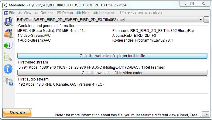

    Dear Sirs,
    none of the export profiles in BD Ripper -> PS3 or MP4 will create a videofile wich is cappable to be streamed by avpnp to my PS3.
    DVD Ripper -> PS3 files work fine.
    I use DVDFab 8.0.5.2 (beta) on a win7 64b HP System with nvidia CUDA 260.99 and Core AVC installed.
    My workarround is to use mediacoder to convert the exported files.
    One item i found in the profiles, the FOURCC Option is set to "1", but that is nonsense. i changed this to H264, but no effect.
    Any suggestions what to do?
    I tested the PS3 Export with BD AVATAR (Europe), 3rd Chapter only, Audio German, Subtitles German, forced only, direct rendered.
    Erna

      Ok,
      i changed all A/V Codec Settings to "Software" and now the PS3-file will play on my PS3-System. See log attached.
      Do you mean this is a CUDA Problem, not a DVDFab one?
      Why does btw Mediacoder create usefull files with CUDA enabled?
