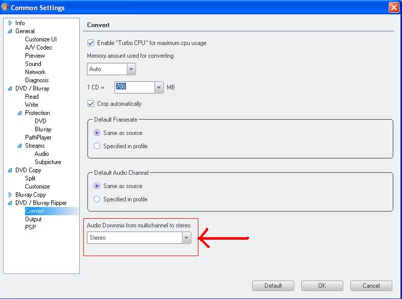

      You should be able to set the default, see picture:

            Hi,90312, I am happy to share this info with you, after you have set the iPod.mpeg4 profile as iPod.default (edited with your changes), and changed the common convert settings to stereo, you have to open the iPod.default file (located in appdata/roaming/dvdfab/profiles folder and change the following;-
            <device channel_ability="2">
            to;-<device channel_ability="0">
