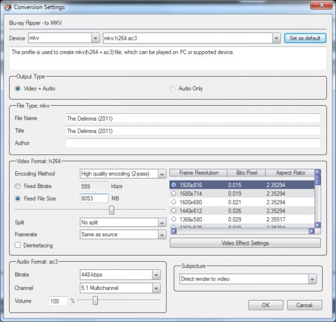

    After updating to the latest version, I was able to successfully start a backup of "The Dilemma" Blu-Ray. The issue I ran into was that the UI wouldn't properly keep track of the selected file size/bitrate.
    If I entered "8053" as the "File Size", the bitrate would stay to some arbitrary low number, such as "559kbps". (see attached screen shot) The bits/pixel calculations to the right also confirmed that DVDfab was going to be using a very low bitrate during the backup.
    The final file size ended up being just under 1GB, most of which was the audio encode. The video itself was a very, very low bitrate & quality. I know there are going to be those that say enable/disable CUDA, but I believe this is a UI issue first.

    I'm able to replicate this issue while trying to backup "True Grit" as well. This happens both when dragging the slider and manually entering a file size into the "Conversion Settings" window.

              Yeah, so I'm not quite a big fan of that logic. The issue I have specifically is that I'm trying to backup "True Grit" and "The Dilemma", both of which are only supported in 8.0.9.7 or newer.
              It would appear that I'm just unable to manually set the file size and that my only option is to manipulate the bitrate to a point where I can achieve the desired file size.

                    Dear all,
                    The problem will be fixed in next version, sorry about that.
                    Best Regards,
                    Fengtao

                        This is still broken in the latest release (8.1.0.0Qt).
                        Although it is fixed somewhat, the filesize/slider still have strange issues. Two I was able to recreate:
                        - Opening Video Settings window to Crop/Rezise a video caused the filesize to revert back to the default value.
                        - Entering file sizes manually causes what seems like the number keys to be mapped wrong. Entering "5" displays "4", "4" displays "3" and so on. Simply try to enter "8053" will come out "8042".
