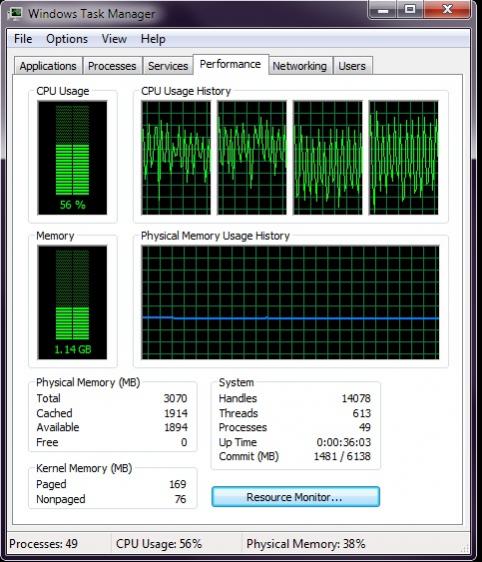

                Version 8.1.2.2 generic.DivX.mp3 does slow to -40 fps on my system and generic.divx.audiocopy rolls along at 140 fps. When using mp3 audio the CPU usage fluctuate wildly while audiocopy is fairly consistent and three times faster. This is why I think there is an issue with the mp3 codec. Screenshots attached:
                Note that both consume all cache memory.

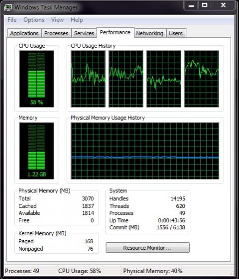

                      Version 8.1.2.3 generic.divx.mp3. The processors go along at near 100% until almost exactly 21% complete then the processors begin to cycle and the fps falls off, way off. I captured a screenshot of this in Task Manager.
