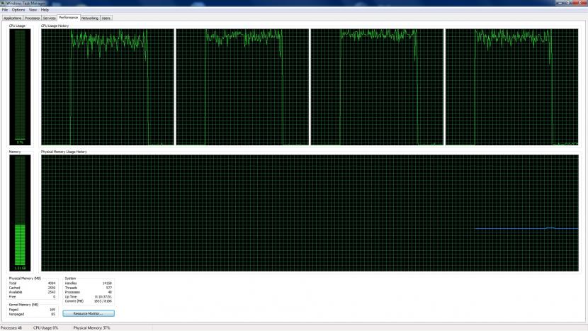

I ran into this on a movie. It ran along like gangbusters until about 12 or 13% then the CPU cycled on all cores and then just quit altogether, no CPU activity at all. I tried the same movie with two other programs in my toolbox and it completed successfully. See attached screenshot:
