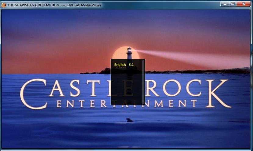

Is there a way to get this done? I selected 5.1 multichannel but this only gave me stereo when I played it back on my TV. Thanks to all who respond.
How do I get Dolby Digital 5.1 with AppleTV3 preset?
No one? I been searching and have not found an answer to this using dvdfab. On another program that i wont mention :-) I did get it to work but I had to choose 6 channel discrete (which played back as dolby digital 5.1 on my receiver) I really would like this to work with DVDFAB since that other program does not play well with subtitles. I wonder if this is even possible with DVDFAB. Can someone please confirm if it is or isnt. Thanks
From what I have read this is a bug in the 5.1 update from Apple. Most find that after the movie starts hold the round button until the menu appears, switch to stereo briefly then back to 5.1 and it will play correctly. If that works for you then it's an Apple problem for sure.How to post the internal log
I don't have an Apple TV3 but everything I do have indicates that Fab is working correctly on 5.1 multichannel.
