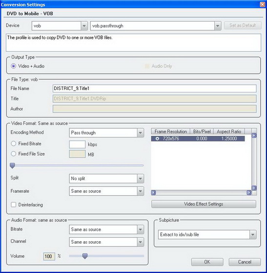

          Hi Monty, thanks for your reply. I'm afraid I cannot see the Direct render to video option - see screen shot.

            Click the dropdown "Extract sub/idx file" is where you should see "Direct render to video".

              Hi W&B, I only get the "Extract sub/idx file" option on the drop down hence my question. Any way of getting the "Direct render to video" option on the drop down?

                I would re-rip main movie selecting all english subs, then when doing the conversion just do the first 2 or 3 chapters then test playback to see if you get the forced subs. (Try the 2nd track since the 1st one doesn't seem to be right)
                The dropdown should give you the option for direct render to video, maybe its because the wrong subtitle was selected?
                (not sure if that would keep it from being in the dropdown)
                Edit: Not sure if direct render to video will be possible for vob passthrough. I never use that profile and someone else may comfirm this.

                  It appears to be a limitation with VOB under DVD to Mobile. If I select Generic then I get the "Direct render to video" option. I'm giving this a go and let you know how I get on. Thanks for your help.
