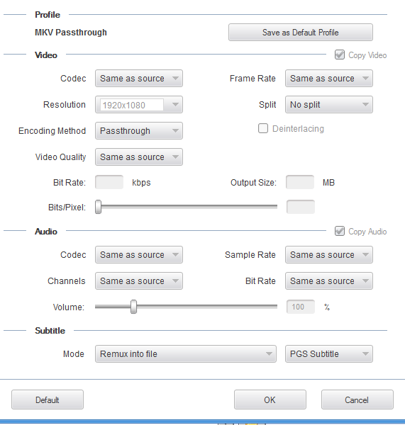

        I took a screenshot of audio copy mkv and have no grayed out areas in advanced settings where do you see grayed out areas or controls?

          Yes, like I wrote, in non-passthrough mode, you can choose to copy video by checking Copy for video (passthrough) and re-encode audio to a different format, by un-checking Copy audio and selecting AC3 or aac to re-encode to. Whether the check box is grayed out or not does not really matter. The option does not do what the old option to remove HD audio did. Instead it re-encodes the audio to a different format. For most Blu-rays, having DTS HD Master, DTS (1536 kbit/sec will then get re-encoded with loss of quality to AC3 448 kbit/sec) Preserving the original core audio is what I want, be it DTS for DTS HD Master or AC3 for TrueHD.

            Now i see settings grayed out.The developers will have to put this back in future releases as the feature is described in their own blog.Good find.Just use the version that worked for you for now.
