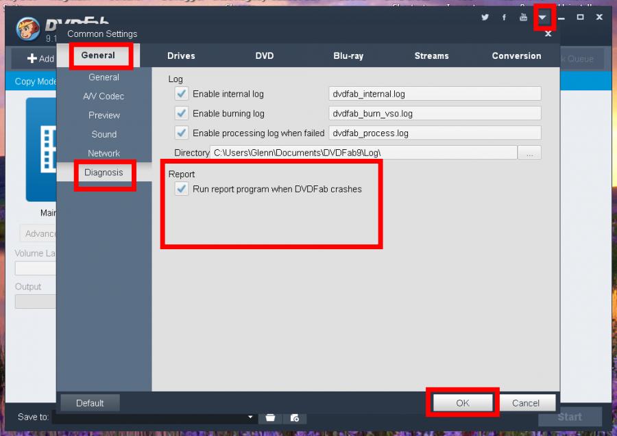

                            I don't think your going to be able to open those files with fab.Is their no Fab crash report when it crashes this is a generated by fab report that comes up and will send the report to fab if you let it thats the report we really need if one comes up it tells developers what went wrong.
                            Please make sure the crash report is checked in fab settings as the screen shot shows try again from disk in drive with the crash settings checked then see if a crash report comes up.We need the information it has cut and paste the information in it to a post.
                              Your screen shot shows a windows message I am looking for a crash report that the fab program puts up on screen.
