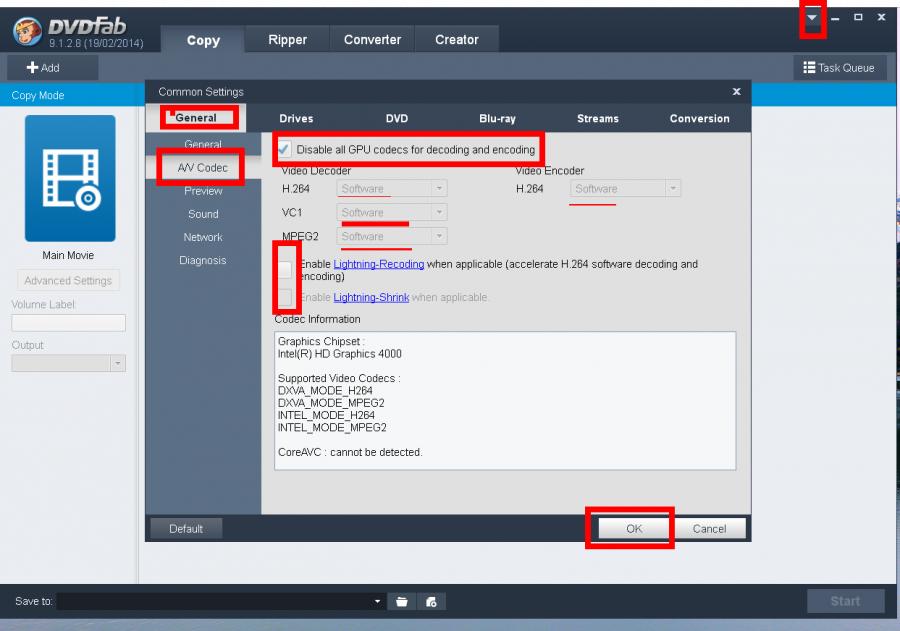

          #19
          You can also go into fab settings and check use all software then try loading the disk.
            #20
            Hello Glenns,
            No luck...
            I run nvidia drivers v314.22 wich is stable for me (have unxeptected issues with more recents, don't hnow why never got an answer from nvidia).
            Have tested on another PC with AMD card, same issue.
            With GPU codec disabled - same issue.
