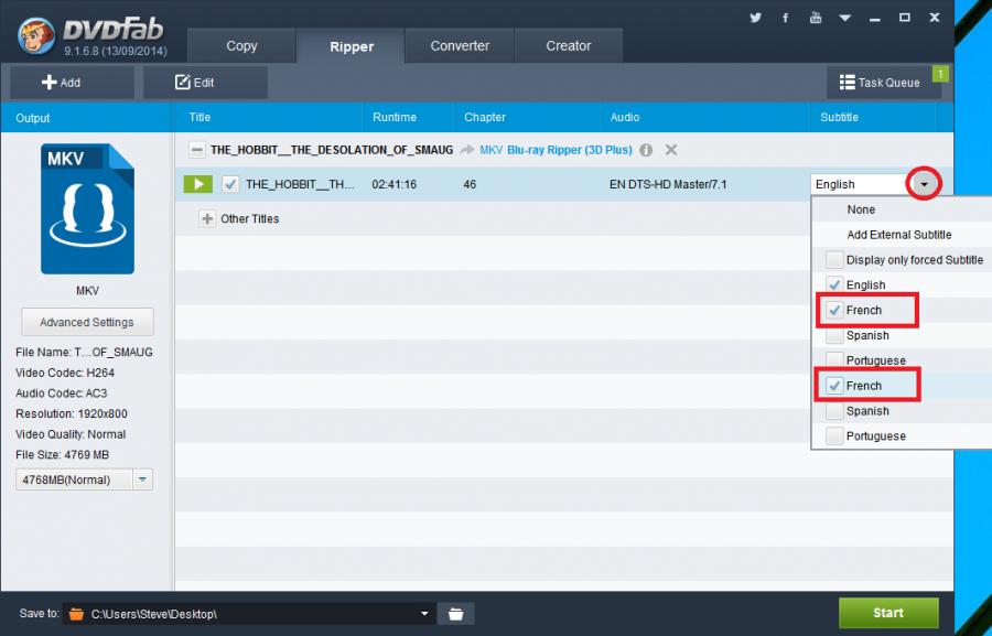

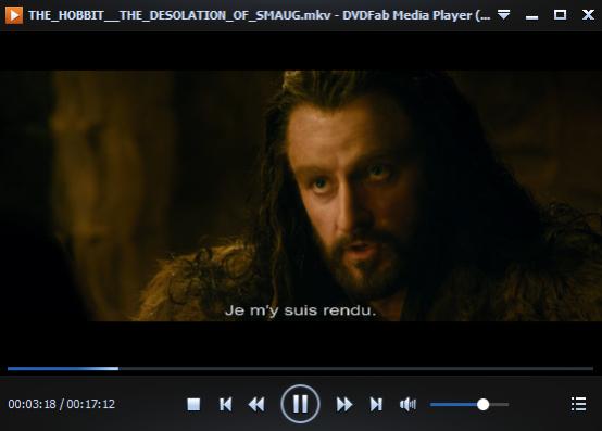

                I gave this a try with Smaug and have no problems. Select the subs I want in the first screen, see subs1 then select French and I assume that's French? See subs2.
