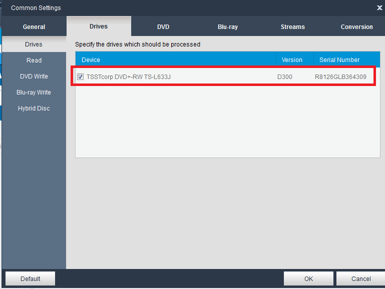

        Did you uncheck your driver V in Common Settings -> Drivers -> Drivers?
        Please check the driver and wait DVDFab read the disc automatically.
