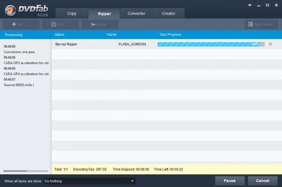

    Odd, I updated to 9.2.2.8 and video to v361.75 this morning and it seems to have picked up the pace for me

      P.S How the hell are you getting fps like that???? now it makes me think I have more problems than I thought.

          If you use AnyDVD with Fab you can expect unpredictable results and you don't need it. If you feel you must, then rip to the HDD and use the folder or iso image as the source then close it out before Fab. We can't compare our system's results, I have more horsepower and was only comparing my own previous results. I'll hunt up a 3D BR around here and see if there is a problem?
            Their is no Cuda or Quick sync help for full 3d movies
            Quickest way is to not compress full 3d movies use main movie or full disk.If compressed then Fab will use software only no matter what the settings are set in the Fab program. Fab will use software only unless making a non full 3d movie like a side by side 3d movie then you can use the cuda or quick sync and it's very fast on a I-5 or I-7 computer.About 20 mins. on a I-7 computer.
