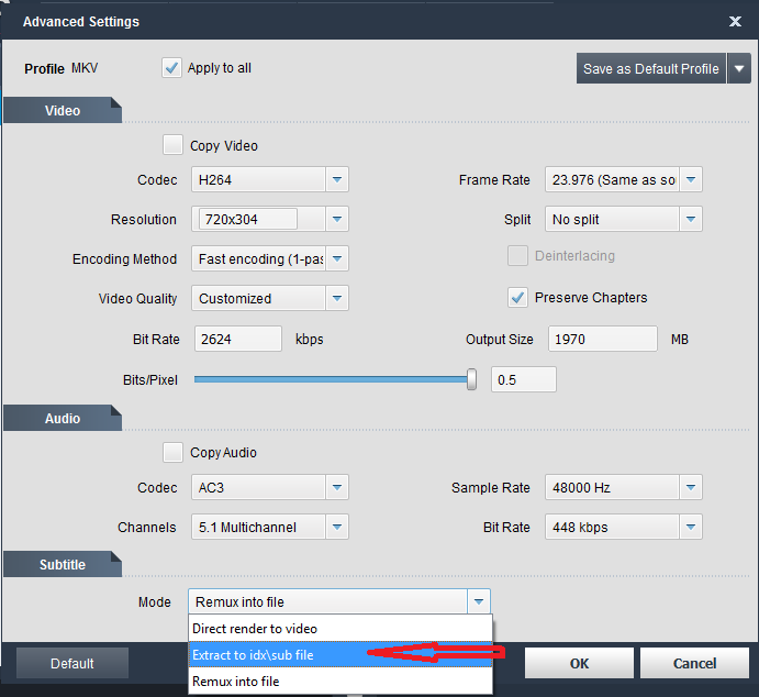

            you mentioned extracting the sub-titles.
            What software would you recommend using for this?
            Then again, I personally don't feel we should have to extract the sub-titles, then import the files with the program we're using to watch the film.
            DVDFab should be able to handle the sub-titles just fine. It's just a matter of finding out what's causing this problem.

              Just use Fab to extract the subs, it will extract two files separate from the movie. See attached:
                Talk about not seeing the forest for the trees!
                I always saw that, but was blindsided and as a result didn't realize that last section was for sub-titles. :LOL:
                Seeing the word Remux I think is what did it as I most certainly did not connect it with sub-titles.
                Talk about feeling foolish after all this time of using this program.
                  Nothing to feel foolish about, if you never use it why would you be familiar with it? And if it works you would only use it on these troubling discs. Hope it works for you. Just keep the three resulting files in the same folder.
                    Well I extracted the sub-title files and it worked as you said.
