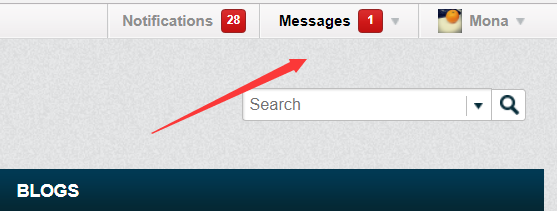

                          After you login DVDFab forum, please check the right top corner area to find out message(s) you received.
                          Please see image attached.
                          Mona
