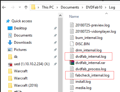

            The fabcheck_internal.log file is in the same location as the dvdfab_internal.log file, please check image attached.
            Please also list other movies that have the same subtitle problem. Thanks.
            Click image for larger version  Name:	LOG path.png Views:	1 Size:	64.6 KB ID:	357658

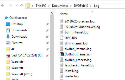

              Here's the fabcheck log. I think I included all of the newest entry. It's hard to tell there's no spaces between entries. It wasn't in the folder with the other logs Click image for larger version
ID:	357673 but I found it doing a search.
