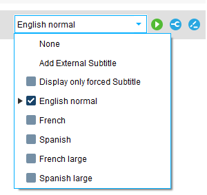

          This is what I use, and note the arrow just to the left of the checked box this turns the subs on by default. If you choose to remux you'll have to turn them off with the player if the arrowhead is present and the opposite is true if not. Click image for larger version

            This is what I use, and note the arrow just to the left of the checked box this turns the subs on by default. If you choose to remux you'll have to turn them off with the player if the arrowhead is present and the opposite is true if not. Click image for larger version  Name:	Sub.png Views:	1 Size:	6.4 KB ID:	358346

            redone and choose both subtitles for this movie and now got them working as intended - have to choose the second set of subtitles for it to display only for foreign languages
