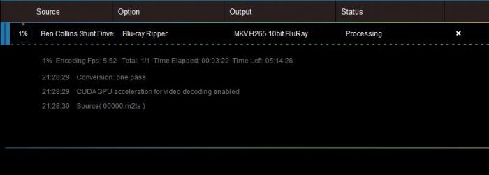

    I've noticed on some titles that CUDA GPU acceleration for video h265 enconding enabled does not kick in, so wants to take over 5 hours to rip a 1 hour title.
    Not showing

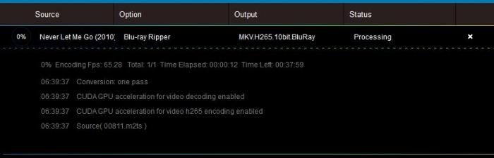

    Showing
    Any ideas on what causes this, when only things that change between the rips are audio and subtitle tracks
