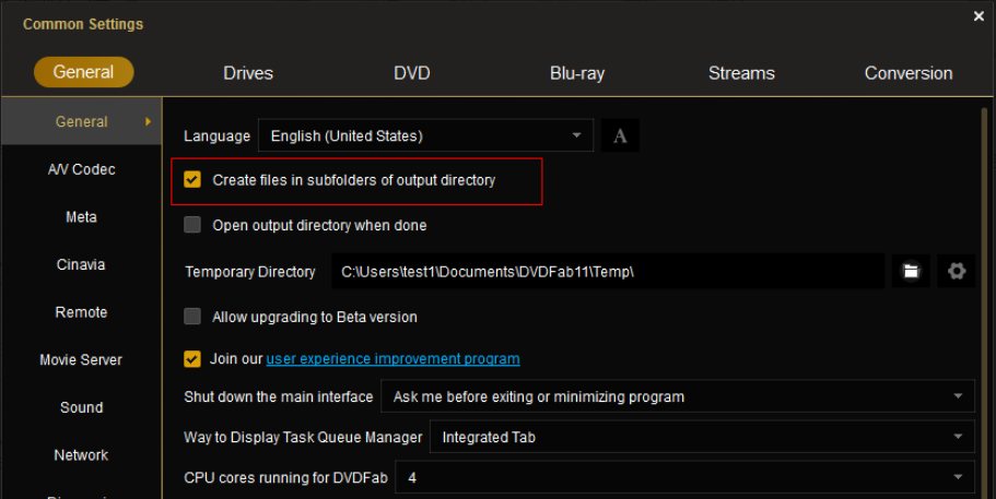

                  You may try to mark this option to have a try. See image attached.
