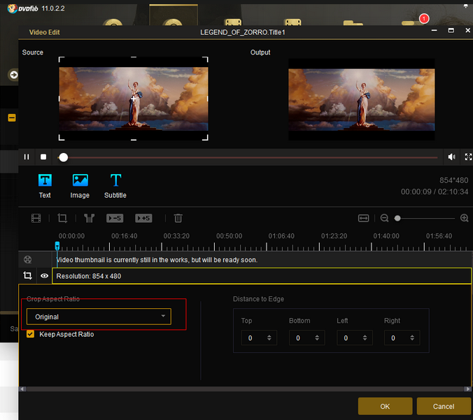

    For problem 1, please play the MP4 in VLC player to see if it has black borders. You can adjust the VLC window to see if it indeed has black borders or if the black borders are added by your player. Or, in DVDFab, go to 'Video Edit', choose "Crop aspect ratio" as Original to convert and then play to see the result. I sent you a screenshot for "Original" setting.

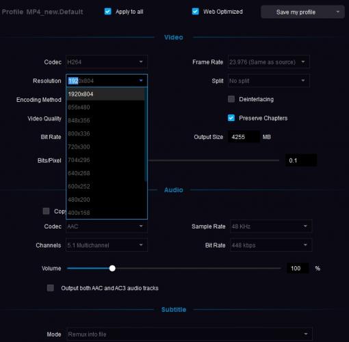

            I don't have that option for this ISO, 1920x804 is the highest. I have another ISO that I ripped to MP4 and it is the same (1920x804), yet it plays in widescreen with no black borders all around the picture. So, I don't think that is it. I'm using the same configuration as far as the MP4 output file, but the image displayed on some have a border all around the movie, while some are just across the top and bottom (normal). And, it's random as far as what the output looks like.

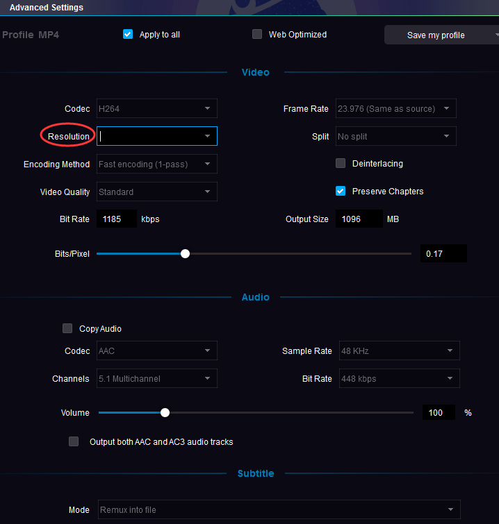

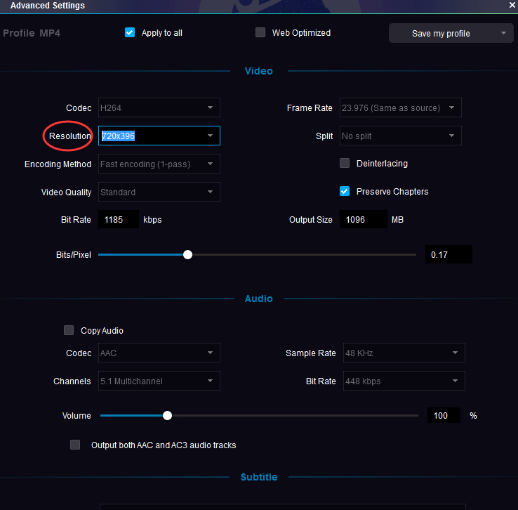

              BTW, you can highlight the current resolution to delete it, then manually put down another one.
                OK. I'll try editing it and using 1920x1024, but, as I said before the 1920x804 works fine on other movies. So, I don't get why it's only working intermittently. Plus the fact that when I burn the ISO to DVD it plays/displays correctly both audio and video. Any news on why the audio gets out of sync? I haven't tried the Handbrake rip, yet. Sorry, I'll try and get to that tonight or tomorrow and get back to you.
