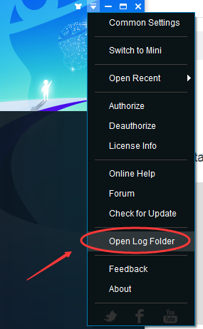

    We need your dvdfab log files to help analyze the problem. Please post dvdfab_internal.log file and fabcheck_internal.log file.
    You can refer to the image attached for info about how to locate the log file:
Name:	open log folder.png
