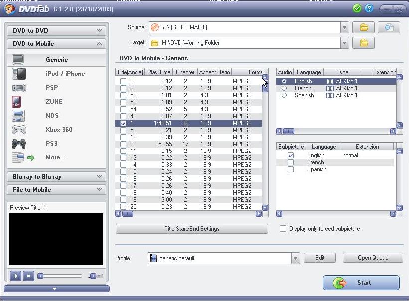

    When I try to rip my home video DVDs to Mobile (.avi), I get no titles in the title area. This function worked flawlessly under version 5.x but stopped when I upgraded to 6.1.2.0. I tried multiple DVDs that I had already ripped under 5.x previously but none of them reported titles under this version. Ideas? I don't see anything in the log (which I attached).
    I have attached a pic of what I see (or don't see) with any DVD inserted.

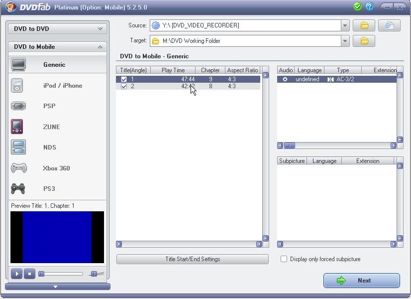

    Additional note... Retail DVDs appear to show up fine. All titles display normally. See attachment pic. Going to try uninstalling and reinstalling. Tempted just to go back to v.5.
      So that you won't think I am nuts... I have uninstalled v6.x and reinstalled 5.2.5.0 and, as you can see, I can see the titles on my home movies. I am going to stay with v 5.x until I hear what I can try on v.6.x... something is broken somewhere.
