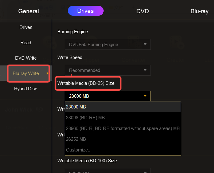

      Did you set the same output size for BD25 for both the Windows and Mac versions?
      Yes, I did.
