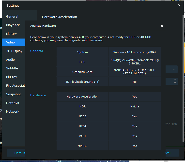

        Hi, please use Player 6 to playback the m2ts file uhd hdr, and repeat the random freeze issue, and then zip the whole Player 6 log folder and send it to us. Also, please go to PC mode>Settings>Video section, and use the "Analyze Hardware" button to run an analysis and screen shot the result and send it to us. I will have the developer check and see what they can find, thanks.
          the log file is to large so here is the upload. https://we.tl/t-L9lPXFWgbu
            I've passed the available information to the developer.
