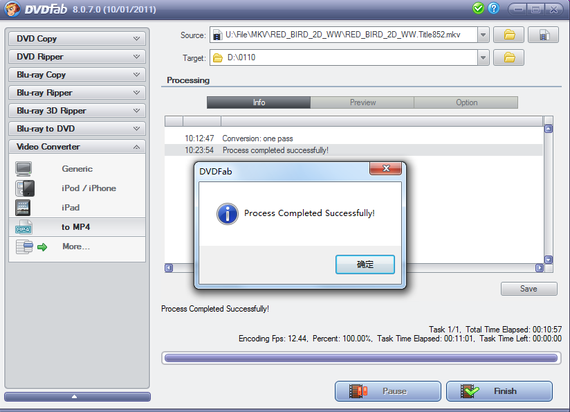

    You set A/V as software and encoding mothodes as 1-pass to retry,CUDA not support any generic profile.

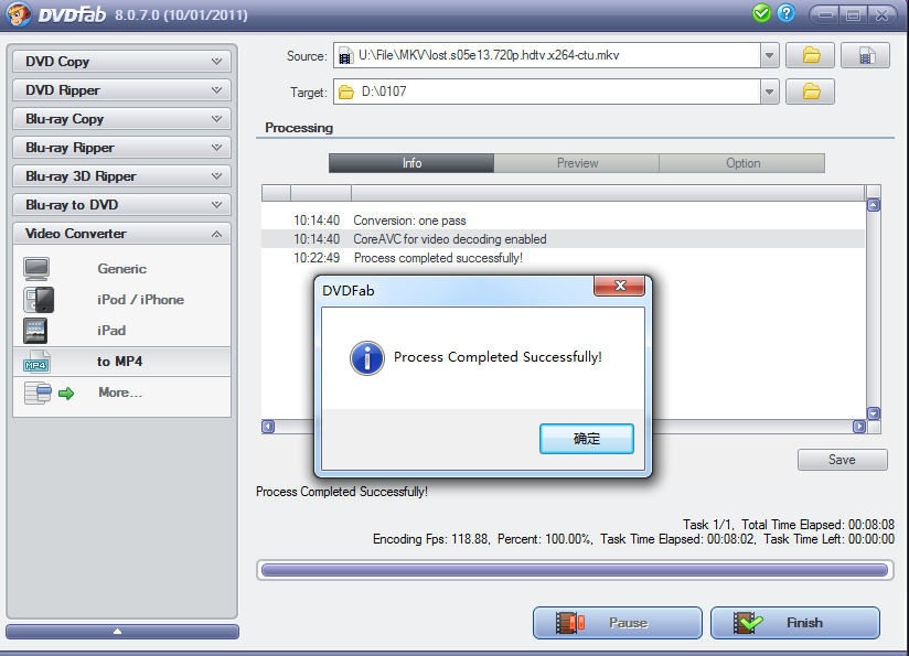

        You set A/V as software/CoreAVC and encoding mothodes as 1-pass to work well.
          Your attachments are showing V 8070 and a date of 10.01.11
          So you are using a version that is not yet released to the rest of us?????
            Gruñón, David$ is from Support and therefore has a newer build, of course.
